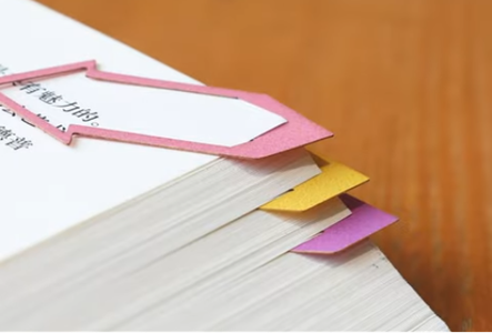

Step 6: Complete the Colorful Bookmarks Cutting
When the laser cutting colorful bookmark is completed, it’s time to get it out! No special treatment required, just take it out and lightly wipe the dust off the surface.
TIPs:Paint tape is a great tool for quick and easy cleanup of paper scraps from laser honeycomb bed!
laser colorful paper bookmarks show
