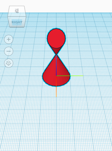

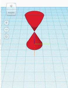

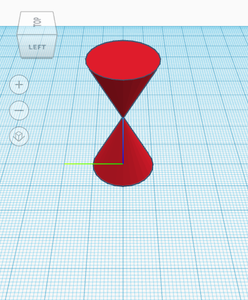

Step 3: Creating the Double-right Cone
We will now create the double right cone, which will serve as the base of each conic section.
Drag a cone onto the workspace from the Shapes column. Then drag a move block under the cone by going to the Modify column. The cone can be lowered to the ground by changing the "z" to 10 instead. Steps 1-3 must be repeated one more time for the process to happen twice. Under the second move block, insert a rotate block from the Modify column. Adjust the rotate block so that it rotates 180 degrees around the axis-y. Insert an "X: Y: Z:" block from the Math column after the pivot on the rotate block, changing the "z" to 20.
Check to see if your code creates a double right cone by clicking the play button at the top (to the right of speed). Your screen should now appear as shown in the above picture.

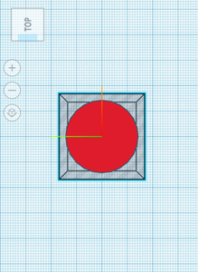

Step 4: Generating Circle
The first of the four conic sections, the circle, will be formed right away.
Drag a "Create New Object" block from the Modify column onto the workspace. Then, choose "Rename Variable" and give the object the name "Circle." Subsequent to the Create New Object Block, enter the code for the double right cone. To transform a box into a hole rather than a solid, drag a box from the Shapes column and then chose the gray circle with angled stripes. Change the "z" value to 45 by dragging a move block underneath the box. Drag a "Create Group" block beneath the moving block from the Modify column. Drag a "Pause" block below the "Create Group" block in the Control column. Drag a "Delete Object" block from the Modify column under the Pause block. Drag "Circle" from the Data column into the Delete Object box.
The code is stopped by the pause block until you press play. This is done to allow you to examine the conic section that the code generates. Once you have a grasp of it, you can press play to move on to the next one.
Check to see if your code creates a circle by clicking the play button at the top (to the right of speed) and switching to the top view of the workplane. Your screen should now appear as shown in the above picture.

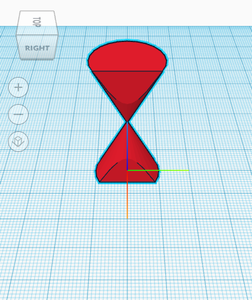

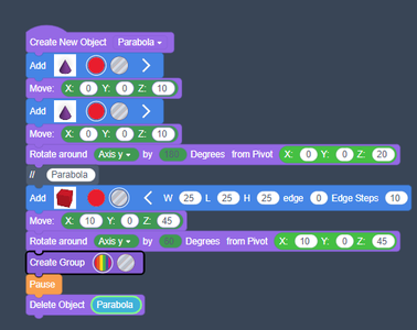

Step 6: Generating a Parabola
The third conic section, a parabola, is what we'll create next. This one is a little trickier to spot, but looking for a U-shaped curve can help.
Make a new object and give it the name "Parabola." Underneath it, enter the code for the double-right cone. To change the dimensions to 25x25x25, add a box underneath it, make it a hole, and click on the arrow to the right.
By dragging a move block underneath it, change the "x" and "z" to 10 and 45, respectively. A rotating block should be added and modified to rotate by 60 degrees around the axis-y. Make the "x" 10 and the "z" 45 by going to the Math column and inserting an "X: Y: Z:" block into the empty space after Pivot. Place a "Create Group" block beneath the rotate block, followed by a "Pause" block. Drag "Parabola" from the data column into the empty space after dragging a "Delete Object" block from the Modify column.
To see the parabola's code in action, press the play button once, then press it again whenever it pauses. Check to see if your code creates a parabola by switching to the right view of the workplane. Your screen should look like the image above.

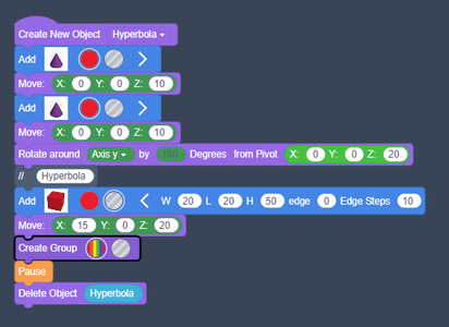

Step 7: Generating a Hyperbola
The final main conic section, a hyperbola, is what we'll create next. This one is also a little tricky to see, but it helps to look for two symmetric U-shaped curves near the intersection of the two cones.
Make a new object and give it the name "Hyperbola." Underneath it, enter the code for the double-right cone. To change the dimensions to 20x20x50, add a box underneath it, make it a hole, and click on the arrow to the right. Change the "x" and "z" to 15 and 20 respectively by dragging a move block beneath them. Place a "Create Group" block beneath the moving block, followed by a "Pause" block. Drag "Hyperbola" from the data column into the empty space after dragging a "Delete Object" block from the Modify column.
To see the hyperbola's code in action, press the play button once, then press it again whenever it pauses. Once there, check to see if your code creates a hyperbola in the right view of the workplane. Your display ought to resemble the one shown above.
