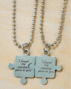

Let’s celebrate love and connection with laser cutting couple puzzle necklaces! These beautifully interlocking pendants are more than just accessories, they’re a symbol of how two unique pieces come together to form something whole.
Whether you’re marking an anniversary, planning a special surprise, or simply want a keepsake that speaks from the heart, each necklace tells a quiet story of closeness and belonging. With clean, precise laser cutting, every curve fits perfectly—just like the people who wear them.

Stainless Steel Puzzle Necklaces

Once laser marking is complete, carefully open the door and get your personalized stainless steel couple puzzle necklaces. Laser marking does not produce toxic substances, and you can wear them after a simple cleaning!
