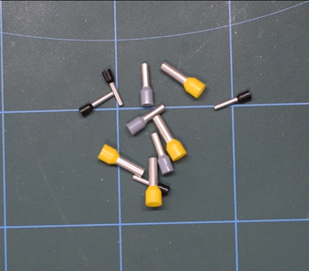

Starting by removing the plastic sleeve from the terminal and keep the metal part that is gonna be the main body of our caps.
With my wrap 'n tap pliers, I made a loop on a piece of copper wire that I set on top of the metal cylinder. I wrapped the wire around the body to secure the initial extremity, with a first coil on top, and then I made a second coil on the bottom. After that, I cut the excess wire and I bent the final extremity to keep it from sticking out.
