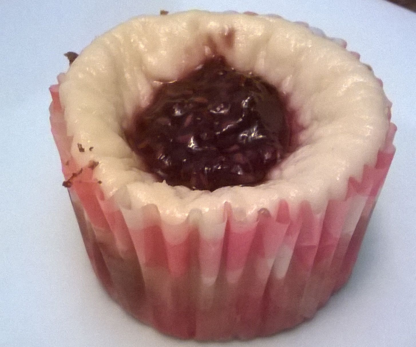

For making filled chocolates, it's a little more involved. This process works best with dark chocolate, adequate with the milk choc, and not at all with white. Put the molds in the freezer beforehand, to ensure that they're very cold. Melt the chocolate fully, and pour into the cold mold until it covers all internal surfaces. Pour it all back out of the mold, leaving a thin shell that solidified on the internal surfaces. The thicker the shell, the less likely it is to break while demolding, but also the less volume it'll have for fillings, so use your judgement. Put back in the freezer to allow the shell to solidify fully.
Prep your filling material. In my case, it was either peanut butter or nutella, so I basically just melted it. Use a spoon/spatula to drip or scrape the filling into the chocolates, allow just enough space for a final coating. Lastly, pour molten chocolate into the mold to fill up the end and cap off the filling. Place in the fridge/freezer until solid, demold, and you're done!
