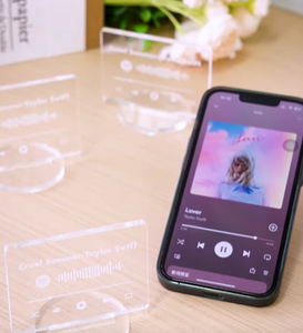

Let’s craft a laser cutting acrylic custom song display! This sleek and modern design brings your favorite music to life with precision-cut, making it a perfect addition to any space.

When the laser cutting acrylic song displays is completed, it’s time to get it out. Then it’s just a fun assembly time to get the ideal custom song displays. Imagine the joy of assembling the song displays, as each piece clicks into place to create a beautiful, layered home decoration.
Come and Try!
Laser cutting on acrylic custom song displays adds a unique, personal touch while ensuring precision and durability. Whether you’re creating a special gift, decorating your space, or showcasing your favorite song in a sleek, modern way, laser cutting offers a stylish and lasting way to bring music to life!
assemble custom song displays
show custom song displays
