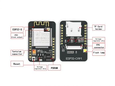

Step 1: ESP32 Cam Module
The ESP32-CAM is a tiny camera module with the ESP32-S chip that costs less than $10. The ESP32-CAM can be used in various IoT applications. The ESP32-CAM can be used to take high-quality still images and videos. The ESP32-CAM can also be used as a security camera.
The ESP32-CAM is ideal for low-power applications such as security cameras, drones, and industrial IoT applications. The ESP32-CAM can be powered from 5V or 3.3V and features a built-in USB-serial converter for programming and debugging.
The ESP32-CAM is ideal for security cameras, drones, and industrial IoT applications.
ESP32-CAMFeatures
  • Onboard ESP32-S module, sustains WiFi + Bluetooth
  • OV2640 camera with flash
  • Onboard TF card slot, supports up to 4G TF cards for data storage
  • Supports WiFi video monitoring and WiFi image upload
  • Supports multi sleep modes, deep sleep current as low as 6mA
  • The control interface is accessible via pin header, easy to be integrated and embedded into user products

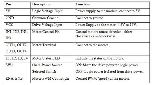

Step 2: L298N Module
An L298 module is a dual H-bridge driver module that is typically used for controlling motors. It is also used for other purposes such as voltage regulation and DC to DC conversion.
The module has two H-bridges that can be used to control the speed and direction of DC motors. The module can also be used to control the voltage and current of AC motors. The module is typically used for controlling motors

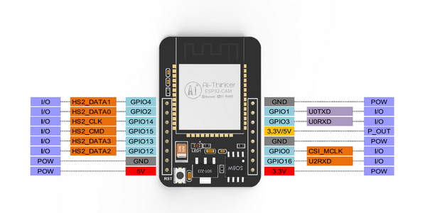

Step 3: Schematics Diagram
Now for powering the car we will use a 12v Li-ion battery, and connect accordingly
+Ve of battery to ---- +12 of L298N
-Ve of battery to ----- GND of L298N
For powering up the ESP32-CAM module we will use L298N's +5v as a source to do this Place the power jumper which is left on board.
connect :
L298N
+5 -------- 5v of ESP-32 CAM
GND -------- GND of ESP-32 CAM
IN1 --------- GPIO 14 of ESP-32 CAM
IN2 ---------- GPIO15 of ESP-32 CAM
IN3 ---------- GPIO13 of ESP-32 CAM
IN4 ----------- GPIO12 of ESP-32 CAM
since we are not going to control the speed of the car and will run at max speed place the ENA and ENB jumpers in place.

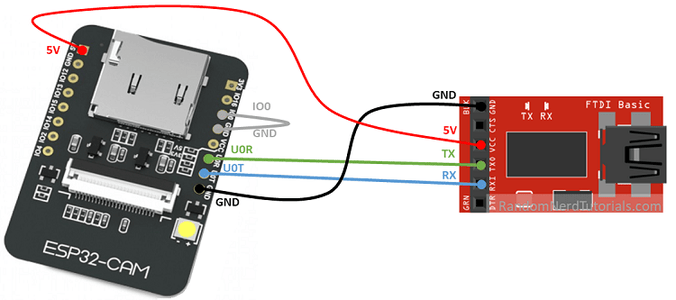

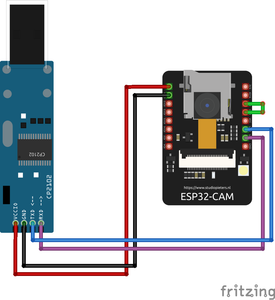

Step 6: Uploading Code to ESP32-CAM Module
Plug in the camera to the connector of the ESP32-CAM board.
Programming of ESP32-CAM is done via CP2102 USB to TTL UART serial converter Module. First, connect the USB to the TTL module with ESP32-CAM and short IOO pin of ESP32-CAM to GND according to the above diagram.
open the files menu in Arduino IDE. and then open preference and paste the link in additional boards managers URL and press
Upload Source code
  • Select the Board "Ai thinker ESP32-CAM"
  • In the sketch uncomment the model of the ESP32 CAM you are using.
  • Put in the WiFi credentials and Upload.
  • Once the ESP32 is burned.
  • Disconnect the GPIO0-GND jumper and reset the board, look at the IP printed on the Serial Monitor.
