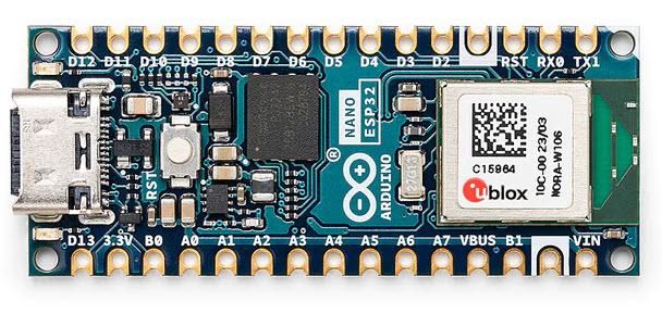

  • Arduino Nano ESP32 (or any other board)

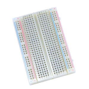

  • Breadboard

Step 2: The Circuit

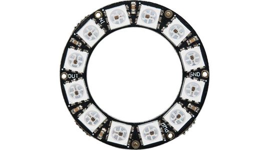

  1. Connect LED Ring pin [VCC] to Arduino pin VBUS or 5V]
  2. Connect LED Ring pin [GND] to Arduino pin [GND]
  3. Connect LED Ring pin [IN] or (DI) to Arduino digital pin [6]
  4. Connect Microphone module pin [VCC] to Arduino pin [VBUS or 5V]
  5. Connect Microphone module pin [GND] to Arduino pin [GND]
  6. Connect Microphone module pin [DO] to Arduino digital pin [2]

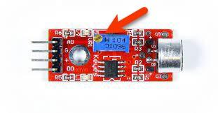

Step 3: Calibrate the Microphone
Slowly rotate the trimmer until the second LED is off, and turns ON only if you make a sound.

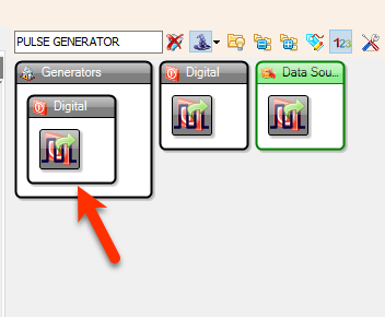

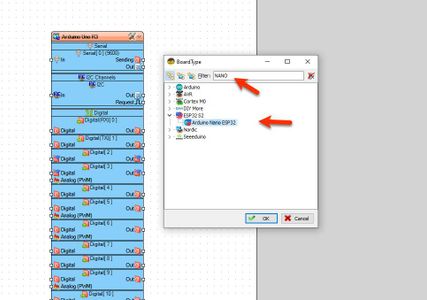

Step 4: Start Visuino, and Select the Arduino Nano ESP32 Board Type
Start Visuino as shown in the first picture Click on the "Tools" button on the Arduino component (Picture 1) in Visuino When the dialog appears, select "Arduino Nano ESP32" as shown on Picture 2

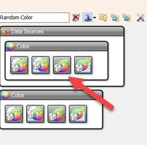

Step 5: In Visuino Add Components
  1. Add "Clock Multi Source" component
  2. Add "Random Color" component
  3. Add "NeoPixels" component

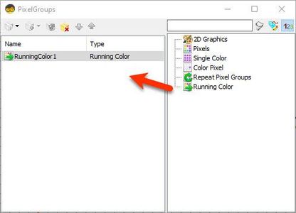

Step 6: In Visuino Set Components
  • Double click on the "NeoPixels1" and in the "PixelGroups" window drag "Running Color" to the left
  • On the left side of the "PixelGroups" window then select "RunningColor1" and in the properties window set "Count Pixels" to 12 or 16 (Depends on how many LED your LED ring is having)
  • Close the "PixelGroups" window
