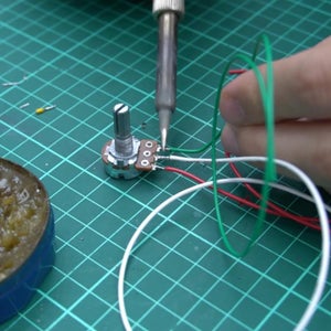

Step 2: Schematics
The electronic circuit of this project is very simple. We are using a potentiometer in order to transfer turning angle into electrical signal. In addition, our Arduino Leonardo board will read these signals and communicate with our PC over USB. You can check the schematic below while building it yourself.
