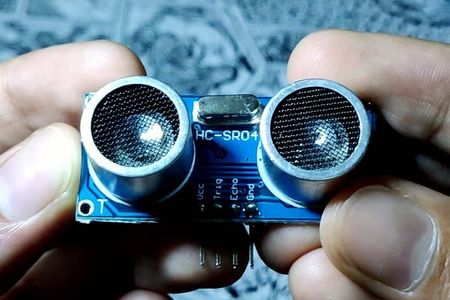

Step 2: More About HC-SR04 Ultrasonic Sensor
HC-SR04 is a popular ultrasonic sensor which has a range of 2cm to 400cm. The sensor uses SONAR (or ultrasonic sound) waves to detect object. The transmitter part of the Ultrasonic sensor transmits pulses and the receiver part receives the reflected waves. The sensor has 4 pins as shown in the figure. VCC is usually connected to 5V, GND is the ground pin and Trig and Echo pins are used to transmit and receive the ultrasonic waves.
Step 3: How HC-SR04 Ultrasonic Sensor Works?
When the reflected wave is received, by knowing the travel time of the wave and the speed of the sound, we can calculate the distance. We need to send a pulse of ultrasonic wave, in order to detect any object in its path. This pulse is of 10us (This means, trig pin should be made HIGH for 10us). Then the Echo pin waits to receive the reflected wave.

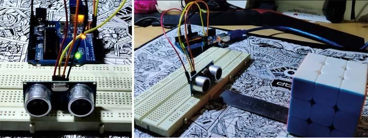

Step 4: Circuit Connections for Distance Meter Using Arduino Uno and Ultrasonic Sensor
As shown in the circuit, Connect VCC pin of Ultrasonic sensor to 5V pin of Arduino Uno. Connect Trig pin of ultrasonic sensor to D10 of Arduino Uno. Echo pin of ultrasonic sensor to D9 of Arduino Uno. And finally GND pin of Ultrasonic sensor to GND pin of Arduino Uno.

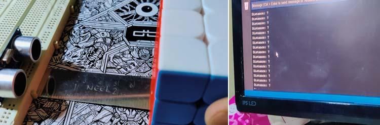

Step 6: Output of the Project
The distance meter measures the distance between ultrasonic sensor and the obstacle placed in front of it by sending out pulses of ultrasonic waves and measuring the duration of the reflected pulse and hence, calculating the distance.
