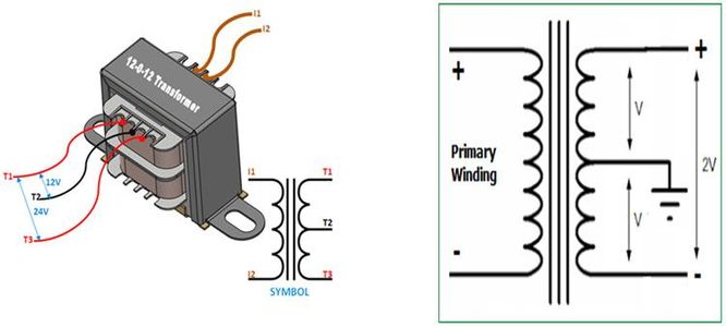

Step 3: Transformer Pin Out
To make this dual power supply circuit, we are using a 12 volt 1.5 ampere transformer. All transformers have two sections. One is Primary section and the other one is secondary section. Primary section is for input voltage and secondary section is for output voltage. 220v AC cable is connected with primary section of transformer and 12v AC output from secondary section.
In the secondary section, there are three cables. If we count it’s cable as a like T1, T2 and T3. Here T1 and T2 contain AC 12v, T1 and T3 contain AC 24v, T2 and T3 contain AC 12v.
