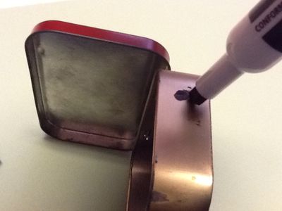

Step 7: Prepare the Altoids Tin
First, you need to make sure your Altoids Tin is completely empty. Now, you are going to need your screw driver, or a drill if you got it. Also, you will need your marker.  Stand the Altoids Tin on its side by forming a 90 degree angle with the lid and the base of the tin. Make a small mark on the right side of the Altoids Tin. Now, using your screw driver or drill, make a hole on this mark that can fit the audio cable. Once you have made a hole, insert the cable with the two wires facing forward. Once they are through the hole, connect the two wires on the cable to the two wires of the speaker by wrapping the wires around each other and folding them over (the polarity of the connections does not matter). You made want to add some electrical tape to secure this connection. Once the cable and speaker are connected, connect the cable to a device and play some music (turn the volume all the way up). If you hear music, you are ready to move on to Step 8. If not, check the wire connections and make sure all the insulation was removed. If you are using two speakers, connect both cables to both speakers.

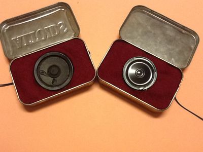

Step 10: Demonstration
In this step, I will show you some of the speakers I have built. Although I used a speaker from a Hallmark Singing Card, you can use speakers from other devices. In the first picture, the speaker to the left is from an answering machine, and the speaker to the right is the one I built in this Instructable  The bottom picture is also the speaker from this Instructable. The sound quality and volume of your Altoids Tin speaker depends on what type and how many speakers you used. I really hope that you enjoyed this Instructable. If you have any problems, suggestions, critiques, compliments, or anything you want to say, please leave a comment, and I will help you if I can.
