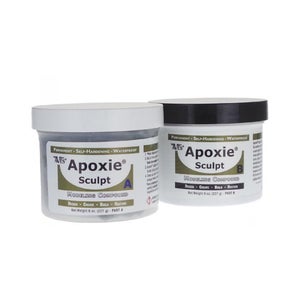

Holes and crevices needs to be filled. I'm using relief paint, but in this case seems not to be enough.
So I decided to use Apoxie Sculpt Modeling Compound.
Apoxie Sculpt is toxic. It's always a good behavior to mix it with gloves.
To sculpt and modeling it, I'm using Silicone brushes and few more modeling tools. I can create shapes and textures to make my piece more organic.
