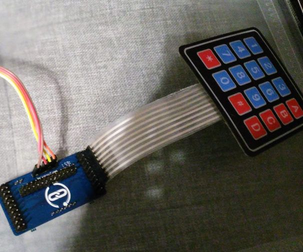

Guess again, we did you a favor. The low cost iolinker FPGA board comes preprogrammed to act as an extension for your microcontroller, that allows you a) to extend your IOs, and b) to link pins, which essentially means you ask for them to be "connected to each other", wait, uh, a few microseconds, and it's done.
You could reprogram the FPGA, but you don't have to. Simply hook it up, use our open source library and get started in minutes. Here's how.

Step 5: Extend IOs and Link Pins!
In your setup() and loop() routines, you can now use the iolinker functions to configure its IO pins.
To set a pin as an input and read its value use
iolinker.setPinType(IOLinker::IOLINKER_INPUT, 0); // P1 is an input
if (iolinker.readInput(0)) {
// Pin is high
// ..do something
} else {
// Pin is low
// ..do something
Note that the pin number '0' refers to the first pin, which is labeled as "P1" on the board. Similarly, the last pin is '48' (P49).
To set a pin as an output use
iolinker.setPinType(IOLinker::IOLINKER_OUTPUT, 1); // P2 is an output
iolinker.setPinType(IOLinker::IOLINKER_OUTPUT, 2); // P3 is an output
iolinker.setOutput(true, 1); // P2 is high
iolinker.setOutput(false, 2); // P3 is low
You can also output PWM signals directly on the first 10 GPIOs of the iolinker chip:
iolinker.setPinType(IOLinker::IOLINKER_OUTPUT, 3); // P4 is an output
iolinker.setOutput(true, 3); // P4 is high
iolinker.pwm(64, 3); // Set P4 to a 50% pulse pause ratio
Why is the value 64? The pulse pause ratio is encoded as a 7 bit value, i.e. it goes from 0 to 127. The max ratio disables PWM -- for it equals the "always on" state. 64 is on about half the time. If you were to connect an LED, it would light up at half brightness. So to turn PWM back off, use iolinker.pwm(127, 3);
To link two pins, proceed like so:
iolinker.setPinType(IOLinker::IOLINKER_INPUT, 4); // P5 is an input
iolinker.setPinType(IOLinker::IOLINKER_OUTPUT, 5); // P6 is an output
iolinker.link(4, 5); // Forward signals from input P5 to output P6
Use iolinker.clearPinFunctions(5); to unset the pin link and reuse the pins for something else.
