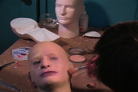

Step 1: Creation of the Heads
So as you saw in the episode each fake head got the same initial treatment. Two coats of liquid latex, one coat of spray paint, then a make-up session to add details. If your head is not going to be seen up close you can skip the latex. All it really does is help fill in some of the little bumps in the surface of the styrofoam. The make-up mostly consisted of darking the lips and adding powder and a lighter flesh tone to the face. I darkened the eyes and apply eye brows before realizing that glasses would cover all that up. If you could get your actor to sit down next to you when you color the head that would be best.

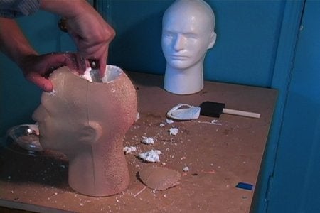

Step 2: Destruction of the Heads (Part 1)
So really you could rig these up any way you want. There cheap and relativeley easy to cut and modify. I tried 3 different ways to rig the head. The first was to work with a stabbing or impaling effect. All I did was cut a quarter out of the back of the head, hollowed it out and made a tunnel to the right eye.

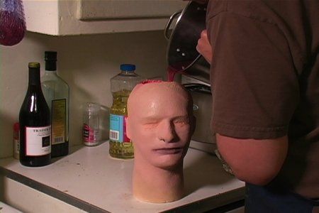

In this empty space I stuffed a freezer bag full of fake blood, then taped it into place. All someone has to do is puntcure the head and the bag and blood will gush out.

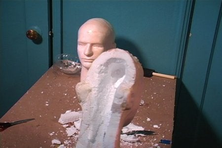

Next I installed the blood shooters from a previous episode into one of the heads. This was a similar process, but instead of of cutting a section out I cut the head in half. Then just tapes in the blood shooter nozzle to line up with a small hole I put in the forehead of the dummy.

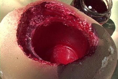

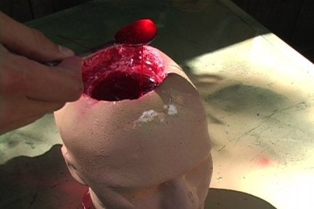

Last, but certainly not least, is the "ballistics gel brain" head. This one looked really cool, but in retrospect was maybe too sturdy. Like the rest I hollow some of the head out. This time I made a deep bowl in the head by digging in from the top.
Next I whipped up some DIY ballistics gel. We are going to do a special "Weekend Extra" on how to make this, but basically it's just water and Knox gelatin with a higher ratio of powder to water then usual. So I poured the "brain gel" in the empty head about half way. Then I lowered a glass into the center and taped it into place. When the gel hardens I can pull this glass out and we will have a perfect little pocket to fill with fake blood. Don't forget to spray the glass with cooking spray so you can get it out.
