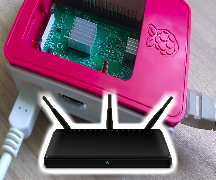

Introduction: How to Make File Server Using Raspberry Pi
Now a days it is common to have multiple computers in one house with music and videos spread between them. Another way to organize your stuff is to keep it on a centralized server aka FILE SERVER.
In this instructables, we will create a file server using raspberry pi.
Let's get started.
