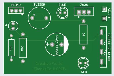

The schematic of this fir alarm circuit, along with the PCB layout can be seen above. Here bridge diode and capacitor used to convert AC to DC. To adjust range of this IR sensor, we don’t use any potentiometer.

Step 3: Transistor Pinout
Transistor Pinout Of BD140 Transistor
We everyone know that, each transistor contain 3 legs. And this 3 legs have different names. BD 140 is an PNP transistor. If we count it’s leg from left side, then 1st led “Emitter” 2nd leg Collector and 3rd leg Base.
Step 4: Connect Power Section
We know that, to convert AC to DC we need bridge diode and capacitor. We use a built-in bridge rectifier to make this circuit. We also can use 4 rectifier diode to make this circuit. To make this circuit, 1st we connect bridge diode and capacitor with the circuit. We utilize JLCPCB (https://jlcpcb.com/RTA) to printout our PCB.
Step 5: Connect Transistor and Voltage Regular IC
After complete power section connection, now we connect transistor and voltage regulator IC with the circuit. To complete this circuit, we need 7-9v. The voltage regulating IC will helps to supply accurate voltage.
Step 6: Connect LED and IR Sensor
For power supply, we’ll use red LED and for danger alert we’ll use blue LED. When the circuit, get power then the red LED will glow. And for the input signal, we are using IR sensor.
Step 7: Connect Resistor With the Circuit
To make this circuit, we used 3 resistor. Those are 100 Ω, 10 KΩ and 1 KΩ. We use 1 KΩ resistor for power section of this circuit.
Step 8: Soldering and Cleaning
Perfect soldering is an important part of this PCBs. While soldering, we have to remember that, there should not any short circuit. After soldering we need to cut-off the extra leg of all electronics component.
Step 9: Use Heat-Sink and Connect Transformer
Now we connect heat-sink with bridge diode and transformer cable with the circuit. Our circuit is now completely ready for use. Now just plug-in power and enjoy the circuit.
