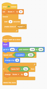

Step 3: Coding for the Pipe Sprite
Select the Pipe sprite and begin coding. You will have to make another variable called score, but this time, make sure the check mark is selected, so you can see your score. You can move the score to the place you want it, and click it to make it bigger (if you click twice by mistake, just keep clicking until it cycles back around again.)
