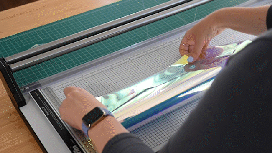

Step 2: Cut the Iridescent Window Film
Cut the iridescent window film a couple of inches larger than the Duralar to allow for a margin of error during the application.

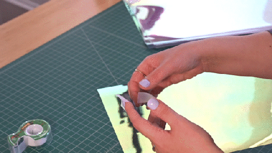

Step 3: Pre-peel the Window Film
Take two pieces of scotch tape and firmly press them against both sides of a corner. One piece of tape should stick to the backing and the other to the film. Peel them apart slightly and then fold the tape over the backing so that it’s easy to peel when you’re in the process of applying it to the Duralar. Remove the scotch tape from the top of the film and set aside.

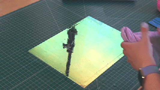

Step 7: Scrape It
Starting from the middle where you placed it, press down firmly with the scraper and pull towards the sides, overlapping each pass as you go. Then do the same thing in the other direction.
Step 8: Finish
Dry the material with a microfiber cloth. Then trim any excess window film off the sides and set it on another surface to dry flat overnight.

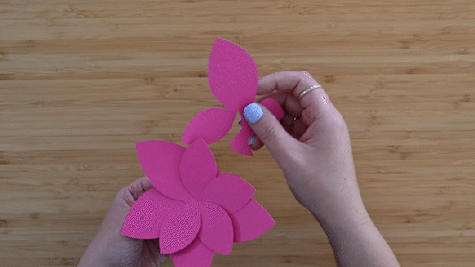

Step 11: Interlocking Flower Assembly
For the assembly, I’m demonstrating with cardstock because it’s easier to see what’s going on.
Note: When I assemble my flowers with iridescent material, I like to use gloves to avoid fingerprints.

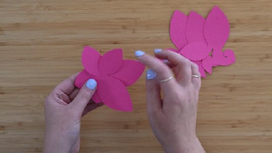

As noted in the previous step, you will need 5 pieces in order to assemble this interlocking flower.

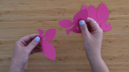

Stack your pieces so that they’re facing the same way and in the same orientation as the image above. Take note of the areas where the pieces hook together. The front “hook” is on the left, beneath the small petal. The back “tab” is on the bottom left. The back “hook” is on the bottom right.
Hold your first piece in your left hand. Take your second piece and hook the two front hooks together. Then spin it around and hook the back tab on the second piece into the back hook of the first piece.
Take your third piece and place the small petal under and to the left of the last piece that you placed. Spin it around until it sits next the previous piece. Then hook the back pieces together.
Each new piece that is placed should be placed to the left of the previous piece.
Make sure everything is hooked together in the back and that’s it for the assembly!

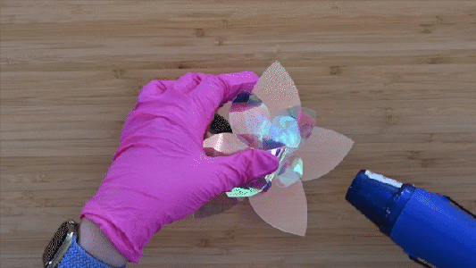

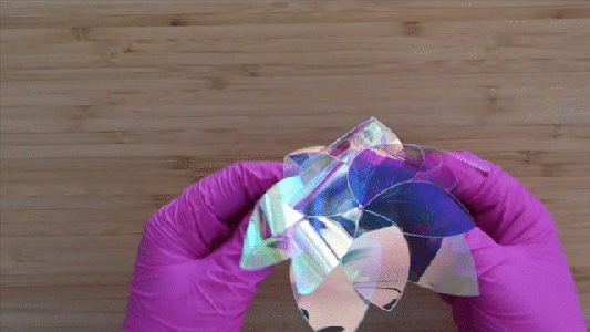

Step 12: Heat Bending the Petals to Curl Them
Place a heat gun or hair dryer on its lowest setting. Curl the petals upward while applying a bit of heat.
Work slowly and don’t leave the heat gun or hair dryer near the petals for more than a couple of seconds at a time.
Step 13: You Made It!
Whew! That was a lot of steps but I hope you find this material as beautiful and magical as I do!
