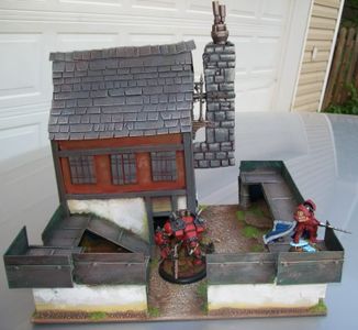

This guide is designed to assist you in using basic skills to make a foam board building that could be used, for example, to create a full scale model as shown with additional supplies. This is a DYI project that can be done at home, in your kitchen or living room or place of crafting and can be done with minimal time, effort, and supplies.
