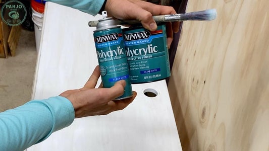

Step 8: Seal Distressed Furniture
To seal distressed furniture, use a coat of clear wax or apply a protective coating such as Polycrylic.
Follow the manufacturer’s instructions regardless of which option you choose.
For this project, I applied 3 coats to protect the distressed furniture from normal wear and tear. Keep in mind, apply multiple thin coats to build up the finish.
Quick Tip: When sealing distressed furniture, use a spray can of the same finish to cover those hard-to-reach places.

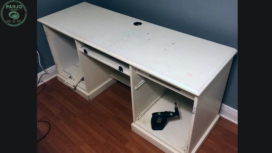

Step 9: Keep or Flip
Once you learn how to antique furniture using paint and stain for an aged look, you can start a side hustle flipping furniture.
I purchased this desk for $75.00 on craigslist for my daughter’s room. After I finished this furniture makeover project, a friend offered to purchase the finished piece for $500. Not too bad after a few hours of my time and $25.00 in material.
