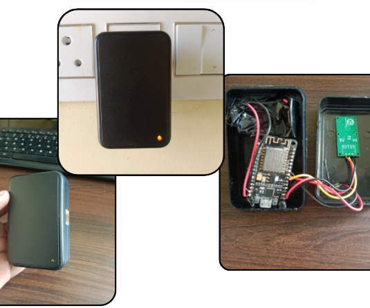

Introduction to GPS Tracker with ESP8266, SIM800L, and SOS Alert System
In today's world, safety and security are crucial concerns, and having a reliable emergency tracking system can be a lifesaver. This project presents a GPS Tracker with ESP8266, SIM800L, and an SOS Alert System, designed to send real-time location updates during emergencies.
This system integrates the ESP8266 Wi-Fi module, SIM800L GSM module, and NEO-6M GPS module to provide precise location tracking. Two push buttons serve as emergency triggers—one for sending an SOS message with GPS coordinates and the other for making an SOS call to a predefined number. This makes it ideal for personal safety, vehicle tracking, or emergency response applications.
The device is compact, low-cost, and can be easily deployed in various scenarios, ensuring that help is just a button press away in critical situations.

Step 2: Cut Necessary Holes for the Components
Cut holes for SIM card, Type-C input for Charging the battery, 2 holes for the push switches, 1 for rocker switch, and one for antenna
Step 3: Glue All the Components in the Enclosure
Glue all the components in the enclosure as the holes we have cut previously

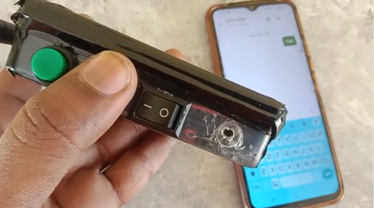

Step 5: Testing
Functions-
  1. Push the first button to make the call to the given phone number in the code
  2. Push the second button to send SOS SMS with location of device with Google maps link
  3. Send Text SMS "call" to the Phone Number of the SIM inserted in the Device from the phone number given in the code to receive call from the device
  4. Send Text SMS "locate" to the Phone Number of the SIM inserted in the Device from the phone number given in the code to receive Location link from the device
