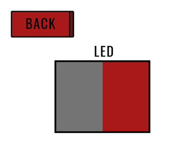

Step 2: Step 2 : Design the GUI
In this step I will design some GUI with photoshop for applying to TFT LCD, the design you can see at the picture. The layout page construct by 4 page, each page have own function.
You can make your own design with other software image but in this instructables I made with photoshop and you can download file PSD right here.

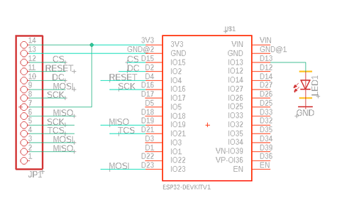

Step 3: Step 3 : Wiring the Component
Now connecting TFT LCD and some LED to ESP32.as picture above, since ILI9341 using logic 3.3 V u can directly connect to ESP32 if u are using microcontroller that are use 5V connect VCC and LED to 3.3V.
here the list of connection :
  1. CS - D15
  2. RESET - D4
  3. DC - D2
  4. MOSI - D23
  5. SCK - D16
  6. LED - 3.3V
  7. MISO - D19
  8. SCK - D16
  9. T_CS - D21
  10. MOSI - D23
  11. MISO - D19
  12. LED - D13
note : the list pin are set up in library you can change the pin number in user_setup at libraries folder and if u are using touch screen don't forget to uncomment TOUCH_CS in user_setup.

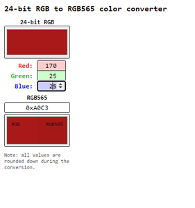

In this project I add two custom color and you can add new color but you have convert it first to convert the color to RGB565. Here is the link to convert color into RGB565 here. The reason why I convert the color RGB to RGB565 because ILI9341 only support 16 bit color.
And this new color that I used :
#define TFT_REDARK 0x60C3
#define TFT_RED2 0xA0C3
#define TFT_GRAY 0x738E

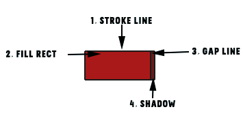

To make layout you have to make a new function in this project there are 4 pages, first we are going to make the first page. The first page consist with 4 button and the title GUI.
As you can see the picture above is the structure of button, to draw the button write this code :
  tft.fillRect(x,y,104,44, TFT_BLACK);//Stroke line
  tft.fillRect(x,y,100,40, TFT_RED2);//fill Rect
  tft.fillRect(x,y,2,40, TFT_BLACK);//gap line
  tft.fillRect(x,y,4,40, TFT_REDARK);//Shadow<br>

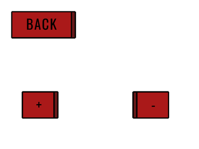

if you already download full the project file in previous step you will see in page 2 inside void loop I add
tft.fillRect(130,90,207,40,TFT_WHITE);
In page 2 there are 3 button back, +, and - whenever you press + button then the screen will add some number in middle of the screen it happens too when you press - button. But what is meaning tft.fillRect(130,90,207,40,TFT_WHITE) that function to replace the previous text if you try remove the code every time you press + and - button the text will print but not replace the old of the text that's why I add fillRect function to make the screen remove the old text and replacing to the new one.
