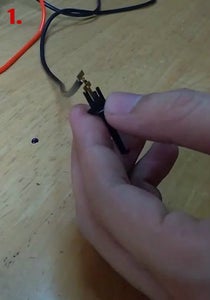

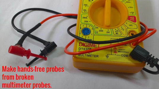

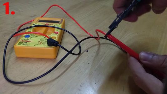

  1. If multimeter probe has broken such that, probes have became asymmetric in length, cut red and black cable accordingly to make them symmetric in length. (as shown in image number- 1 and 2)

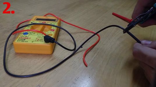

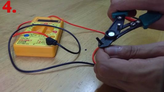

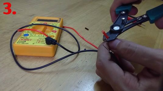

  2. After cutting, now strip these probes using wire stripper. (as shown in image number- 3 and 4)

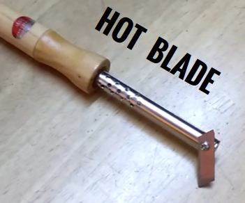

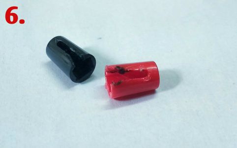

After multimeter probes are prepared, now we need to modify IC hook test clip's cap. Use hot blade to create grooves in cap of IC hook test clips as shown in image number 6.

  3. Wrap stripped cable around the H-shaped metal that lies beneath the cap. (image no-1)

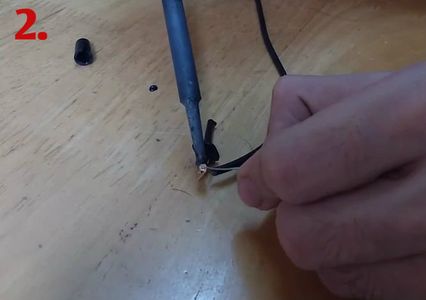

  4. Solder the joint.(image no-2)
  5. Put the cap back on, such that cable passed through the groove. (image no-3)
  6. Apply some hot glue at the junction of cap and cable, making sure it does not touch the inside H-metal joint. (image no-4)

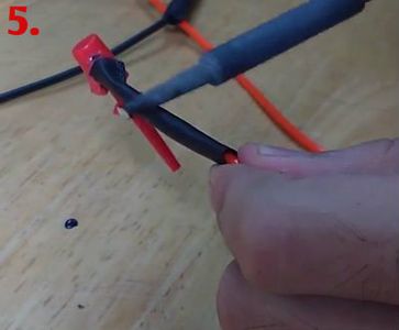

  7. Finally drag the heat shrink tubes till the glue joint and apply heat using solder iron to shrink the tubes. (image no-5)
So there you have it.
