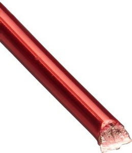

- Wires (any gauge can be used, we are using 28 gauge string (wire can be as long as you want, depends on how many coils you are going to have)

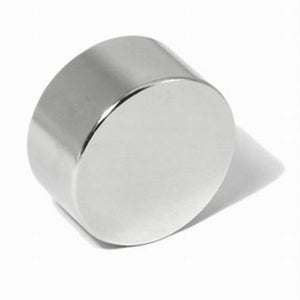

- Neodymium Magnets (we are using 2, you can use as many as you deem necessary)

- Step 1: Get your Magnet wire (28 gauge) and stretch it out to whatever length will provide enough coils for what you are planning, we stretched it around to a foot, and trimmed the extra left.
- Step 2: Using the wire cutters, then cut when the wire is long enough.
- Step 3: Wrap electrical tape around the glue stick before beginning coiling process, this will help removing the coil easier and more efficient.
- Step 4: Begin coiling the wire around the glue stick as many times as needed and keep the spacing to as little as possible and try to make sure the coils don’t overlap each other (depending on how many coils you are using, this process will take longer)
- Step 5: After you’re doing coiling, begin to slide the coil off, we wiggled it off to try to keep the coil from coming apart, remember, if you slide it off and some coils are overlapping each other or are wide apart, redo step 4 so you don’t risk not hearing any sound
- Step 6: Once you have your coil, get the electrical tape and wrap it around the sides of the coil, to keep the coil from falling apart.
- Step 7: Begin to the sand the edges of the coil with the sandpaper until the copper is showing
- Step 8- Redo Steps 2-7 twice so you have 2 pairs of coils

- Step 10: Place both coils in each of the separate lids, and then place the magnet inside of each of the coils.
