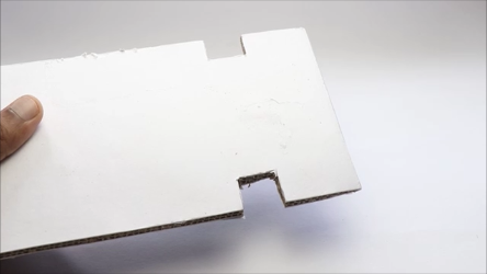

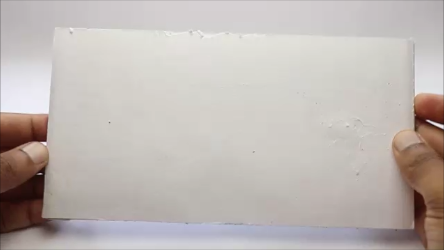

The first step that needs to be done before adding motors and wheels is the frame, Not only these frames are responsible to hold all the electronics components.
There are several options available when you think of building a frame to ṭhe robot cars, I went with a simple yet effective solution.
I will be using cardboard frame, I have made marks on the cardboard earlier considering the sizes of all the electronics.

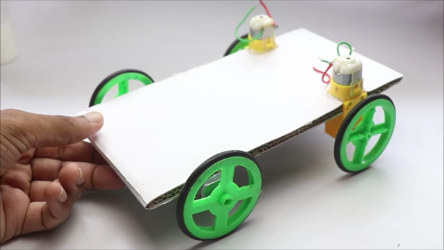

The BO motor or as few call it as gear motor holds most of the space on the frame, Also the type of wheels that we are using plays a crucial role.
Considering all these factors i made this design and it was the best choice i made, The design will not only make the robot look cool but also serves as a case to all the electronics.
Mark the areas and cut it with scissors, Add the BO motor and secure with hot glue.
I have pre soldered the wires to BO motor so that it will be easy later on to work with the electronics circuit part.
After the BO motor is attached we can add the wheels, The type of wheels which you want to use is left to you.
Allow the motor to dry completely and for the rear wheels i simply added the wheels to shaft of normal toy dc motor and with the help of hot glue i glued it to the frame this serves as a rear wheel that moves smoothly.

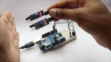

Ultrasonic Sensor (HC-SR04) Connections
VCC and GND are Connected to the breadboard's 5V and GND.
TRIG and ECHO are connected to respective digital pins 11 and 12 on the Arduino.
IR Sensor connections
VCC, GND are connected to 5V and GND, whereas the digital pins to D2 and D3 on Arduino
After these connections are made connect arduino board to computer and open IDE, paste the below code and upload it
Make sure to check for libraries before upload, After the code is done uploading make sure the IR sensor glow when you bring hands close to that
