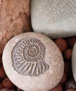

laser etching snail imitation fossil
laser etching dinosaurs imitation fossil
Step 6: Complete the Imitation Fossils Laser Etching
Once laser etching is complete, carefully open the door and get your Imitation Fossils. Laser etching does not produce toxic substances, and you can use the slate coaster after a simple cleaning!
