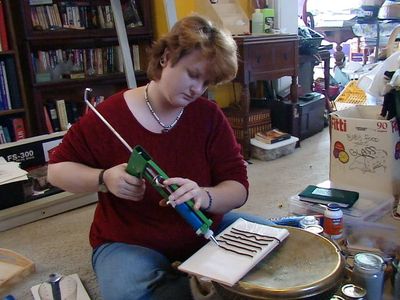

Step 3: Get Ready to Extrude!
Put the dough into the gum paste tube and assemble it. Then put it into your caulk gun. This will let you use the force of your grip rather than having to push down on the plunger with your hand.
With my set up, I have to put it into the caulk gun and then screw on the tip. Your mileage may vary depending on what you find.
Place waxed paper over the cardboard or thin wood that you are using as your rolling board.
Squirt out a few lines of dough. (Note: you may find that you need a little more water here; if so, take out the dough, add a few more drops, and try again.) The lines won't be beautiful, and it will take some practice before you become proficient. Don't worry about that; we'll make it beautiful in a minute.
