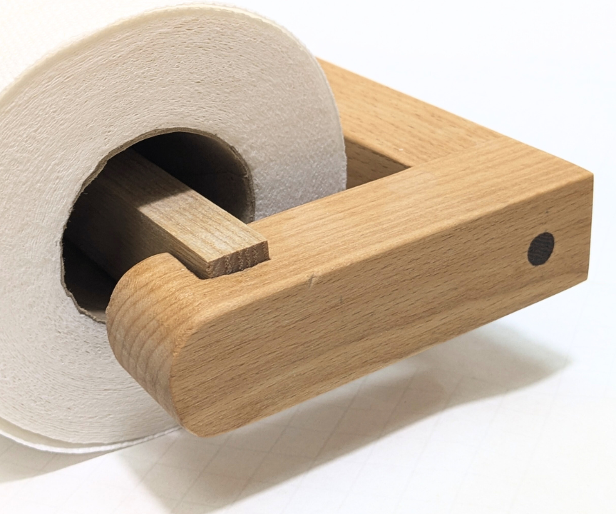

Step 1:
I picked a piece of maple .I started cutting wood
To create such a design that you can see, I had to use a wood part that had the same texture
To better stick the two pieces of wood together, I cleaned the edges with sanding
I applied the wood glue to the required amount between the two cuts
I clamped him tight
Step 2:
I brought a second cut of wood, which I considered for the front of the key
I carefully measured the exact number that I needed
I JOGGED TO CUT THE HOOK WITH THE REQUIRED DRILL
I closed the hooks once to check the size
which was right for me
This hook model I had had easy installation
In this way, a drill is first struck in wood .Then we installed a hook that was bolted
Step 3:
When the sticks I glued together dried up
I found a required pattern to draw a circle on my stick
Then I cut and started sanding
The second cut off that I had hooked, I carefully walked my round wood center
and I glued together with glue
Step 4:
At the end of the sanding phase, I broke down and used wood oil
I think it was pretty .What do you think ؟؟
