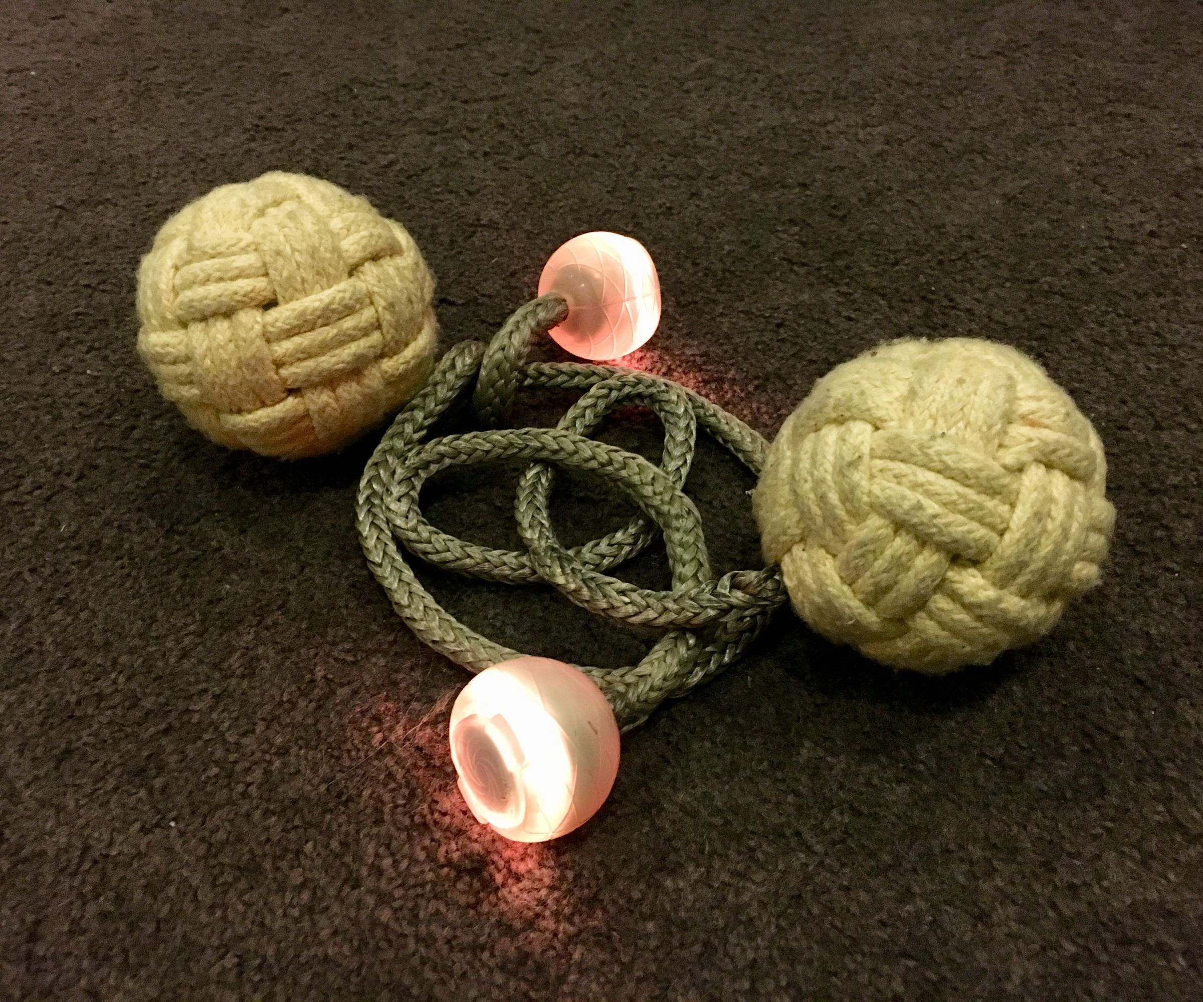

Liven up your tosses, gunslingers, and general steeze with these comfortable lights for your PomGrip handles. This tutorial covers specifically how to alter Pod Poi loop handles, but the same principles can be used to modify most other poi sets as well.

Step 9: Finished!
Voila! Your LED handles are ready to dazzle, and you undoubtedly now have a more intimate relationship with your poi after all those hours of toil. Now go out and spin!
