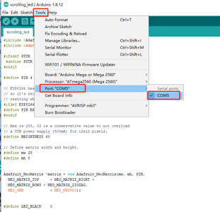

2. Please pay attention to the arrow mark in ws2812B when connecting the circuit, the signal is input by DIN Install library: 1. install the Library file: Open "Tools"-"Library Manager" in the Arduino development software, then search for “FastLED”, and install it.
Code compilation and upload:
1. Choose the development board as Arduino Mega or Mega 2560
2. Select the processor as ATmega2560 (Mega2560), this is to choose the right.
3. Select the port, you can burn the code into the development board.
