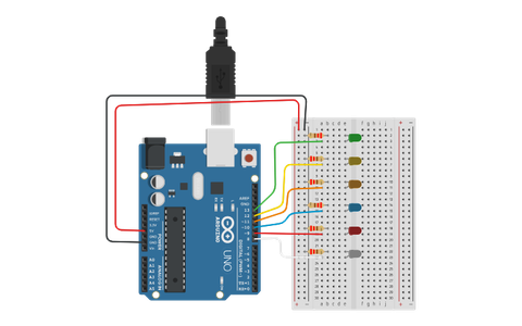

In this project, you will learn how to create a simple yet mesmerizing LED light show using an Arduino Uno. The project will demonstrate how to control multiple LEDs in a sequence to create visual patterns. This is a great way to get started with Arduino programming and learn about digital outputs, basic electronics, and circuit design.
  1. Arduino Uno board
  2. Breadboard
  3. 6 LEDs (any color)
  4. 6 Resistors (220 ohm)
  5. Jumper wires
  6. USB cable for Arduino
  7. Computer with Arduino IDE installed
Step 1:
  1. Setting Up the Hardware:
  2. Place the LEDs on the breadboard. Ensure the cathode (shorter leg) of each LED is connected to the negative (ground) rail of the breadboard.
  3. Connect the anodes (longer legs) of the LEDs to digital pins 2 through 7 of the Arduino using jumper wires.
  4. Place a 220-ohm resistor in series with each LED between the anode and the jumper wire to protect the LED from excess current.
  5. Connect the ground rail of the breadboard to one of the ground (GND) pins of the Arduino.

  1. Uploading the Code:
  2. Verify the code to check for errors.
  3. Select the correct board and port from the 'Tools' menu in the Arduino IDE.
  4. Upload the code to the Arduino board.
  5. Running the Light Show:
  6. After the upload is complete, the LEDs will start lighting up in a sequential pattern.
  7. You can modify the delay time and the sequence in the code to create different light show patterns.
