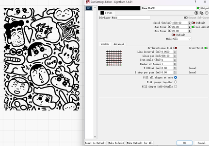

- Speed: 1500mm/s
- Marking Power: 20%
- Frequency: 50kHz
- Line interval: 0.05

Step 2: Import Laser Marking File and Check Out
Load your design into LightBurn software, adjusting its size and position to fit you card holder. Then make sure the laser marking parameters are set correctly.
