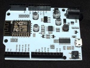

Introduction: How to Make LinkNode D1 Connected to the Cloud Platform
Material preparation
LinkNode D1 x 1
Arduino IDE

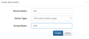

3. My device->Create DIY Device
Enter Device Name,Device Type , Group Name , the device number is 00, device name and device grouping can be any.
Note: Device Type must be selected 00(Custom device type) .

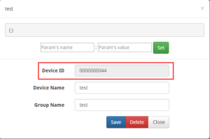

Now you can see “test” in My Devices, Click “test” and record the Device ID.

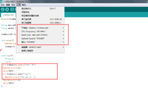

2. Put the code in the following directory(examples under Arduino installation directory )

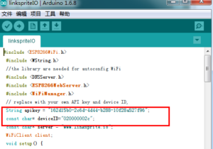

3. Open the Arduino IDE, File -> Example -> LinkSpriteIO-> LinkSpriteIO.ino
4. Modify the “deviceID” and “apikey” with your own
5. Configure LinkNode D1 Engineering Environment
6. compile and run the code

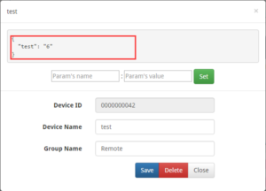

Step 3: Results

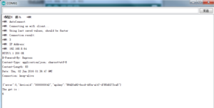

Open the serial port and www.linksprite.io to observe phenomena.
serial port
www.linksprite.io
Here we can see communication of LinkNode D1 and linksprite.io.

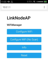

Note: The first use of LinkNode D1 need to connect the WiFi, the specific operation, please refer to the linksprite wiki Tutorial 4 .
