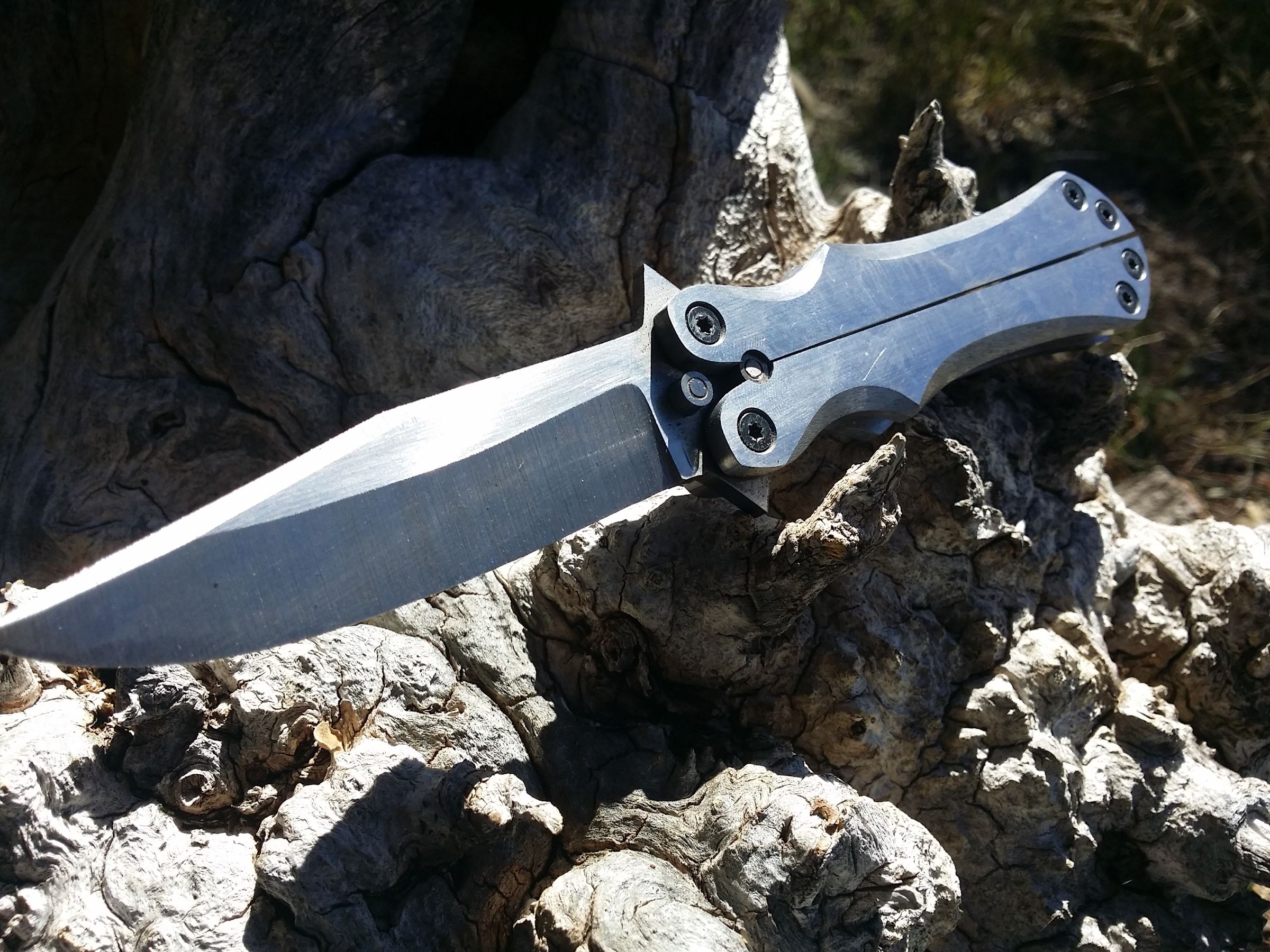

The above two photos are the knives I used with the micarta made in the two videos shown within this Instructable. One video is how to make paper micarta and the other is a camouflage pattern using pieces of fabric.
