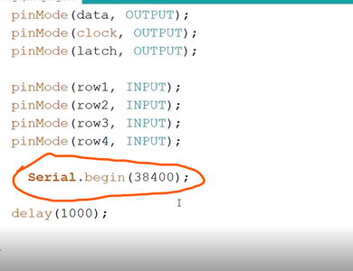

Serial.begin(38400);
delay(1000);

serial.begin( 38400) is actually the baud rate of the software programme hairless midi. go to preference of hairless midi and note down the baud rate and put it on the bracket portion of arduino code. upload arduino code.
