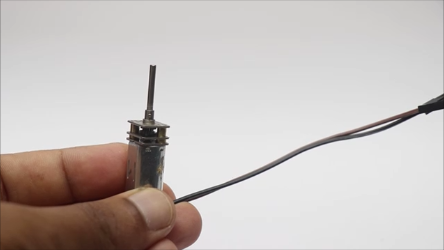

Geared motor N20 Motor from here (chosen because of its small size)

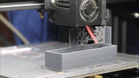

Step 1: Design and 3d Printing
I have designed the Body for this bubble blower machine by myself using tinkercad, You can make the design if you have hands on experience or simply use my STL files that i have given below.

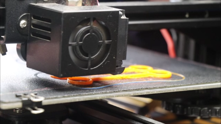

Download the files and open it using slicer, In my case i will be using ultimaker cura, There is nothing to change, the infill was 30%
There is no need of any rafts or supports at the time of printing, There is no need of any post process of the model after it is printed.
The printing time was around 35minutes for the main frame and for the bubble making slots it was 20mins, The choice of color is yours.
Feel free to customize the model according to your needs, scale it if you want to but keep the standard size of electronics in mind

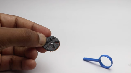

Step 2: Making Bubble Creating Part

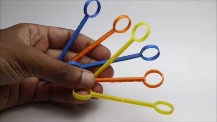

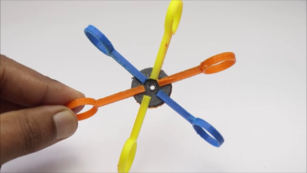

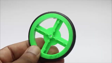

This is the part that is responsible for bubble generation, i have made several designs before coming up with this model.
I have made more than what was needed, I have cut the pieces into 2 and later using super glue i have connected piece by piece using superglue.

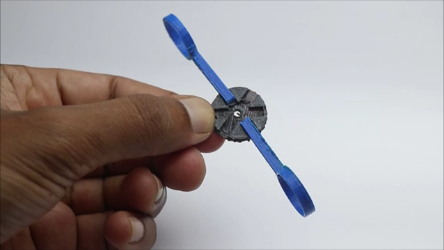

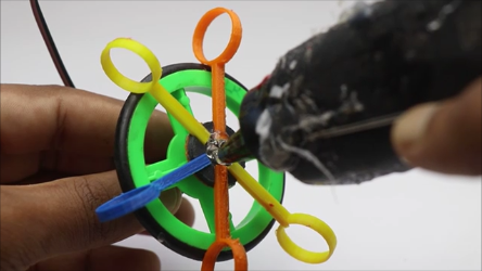

The final bubble maker will look like as shown in the forth image of this step, After that part is done i have attached it to the wheel, This is because if i add this directly it was causing some vibration that will impact the bubble forming process.
After you attach it to the wheel to make it even more stronger add a drop of hot glue to the center.

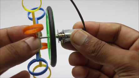

There is no risk of water entering the motor because there are holes that will avoid seepage and also the gears are water proof!I

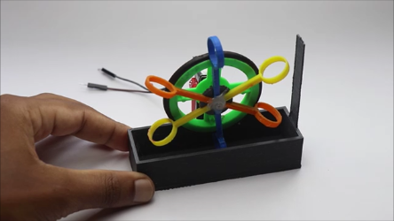

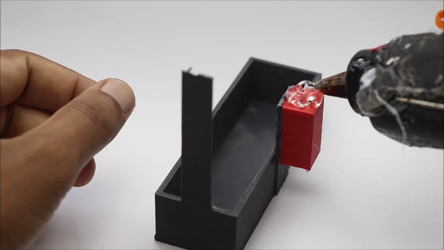

Step 3: Assembling
There is no much assembly required, Already i have given areas on the 3d printed part where you will need to glue the other components.

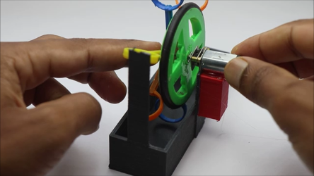

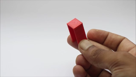

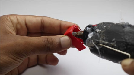

The DC motor that holds the bubble making hardware was coupled first, To do this i used a small piece of 3d printed box and completed the task using hotglue, make sure the glue is not too hot, that may disfigure the model.
Now you can glue the motor setup, hold and wait for some time untill the glue is dry completely.
In the end we can add the dc fan, In my case considering the size the fit was really great, If you are using same size like me it will fit yours too.

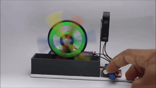

Step 4: Some Electronics

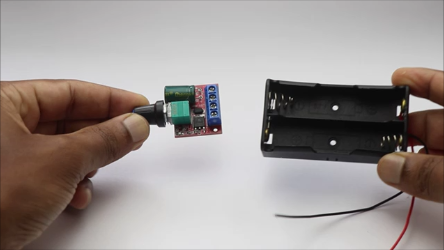

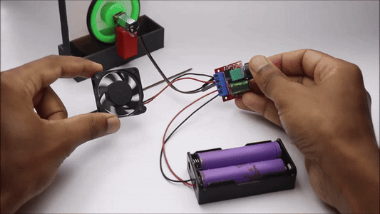

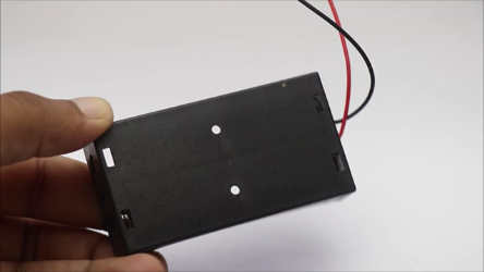

The circuit is very basic and simple, I have used battery holder with removable batteries.
When you are making connections it is recommended to disconnect the batteries, Wires from the holder are connected to the motor controller.

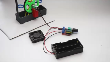

Now connect the dc fan and the bubble making setup motor to the motor control part, In my case will be using a 6v dc fan.
In case if you are using 12v dc fan, You can connect to the battery directly because our battery is providing 7.4v voltage and with this it will blow out enough air to blow the bubbles.
Test the circuit by connecting to the battery and if everything goes fine we can proceed to setting up the electronics on a piece of board.
I recommend using board made from plastic or wood since if you use cardboard it may cause damage because of spillage in anyway.

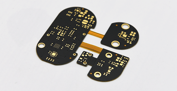

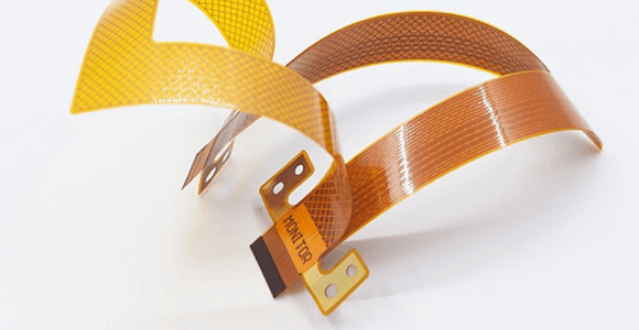

A revolutionary solution that combines the best of both rigid and flexible circuitry to elevate your electronic projects to new heights.
With their expertise in advanced manufacturing techniques, they offer a seamless integration of rigid and flexible components, ensuring enhanced reliability, durability, and space-saving benefits.

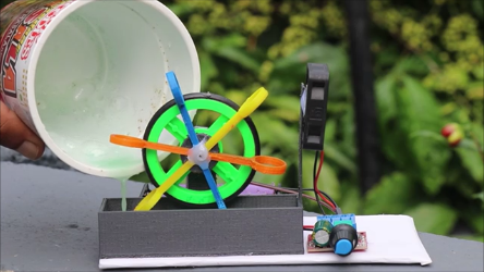

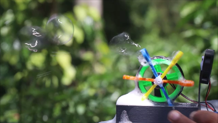

Step 5: How to Use
Using this is soo much fun if you have build this by yourself, You will witness the working of your project you made.

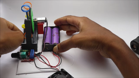

Start by adding the batteries, if you are using other type of batteries i recommend you to have a closed space on this part since exposing to liquids may damage the battery.
Fill the machine with bubble generating liquid, In my case i mixed shampoo and few drops of dish washing liquid together with some water and poured it to the area.
Make sure that the bubble creating part is immersed inside this solution, Now turn on the power knob, The dc fan also should turn on.

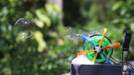

Increase the speed gradually until you see the bubble formation occurs and it starts blowing out.
In my case this setup gave me continuous bubbles for long time, You can increase the bubble time by expanding the bubble solution and storing it on a larger size container while the solution flow to this area using submersible pump.
This was all about this mini bubble blower, experiment with different setups and let me know if you made a better version than me! Thanks for reading and consider watching the video below.
