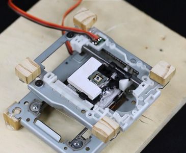

Step 2: Disassemble DVD Writers.
First of all you need 2 DVD writers of your CPU.You can use non workable DVD writer for this project.

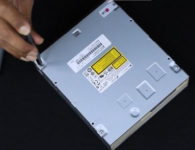

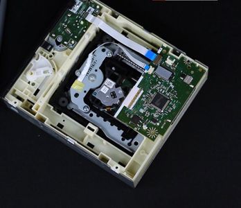

Take 2 DVD writers and open 5 screw on bottom of this DVD writer.Then open bottom case of DVD writer and disconnect all circuit. Then open Top case of DVD writer.

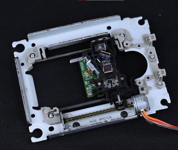

After this you see rectangle part of DVD writer with stepper motor on back side.Open 2 screw on this Rectangle and remove this rectangle outside.
Repeat this process for 2nd DVD writer. After this you have two PCs of Rectangle Part (AS per 2nd Pic.)

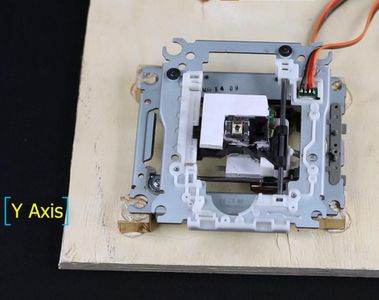

Step 4: Connect With X-Y - Axes Gantry.

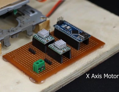

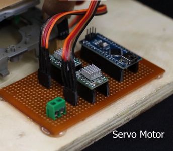

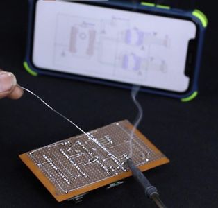

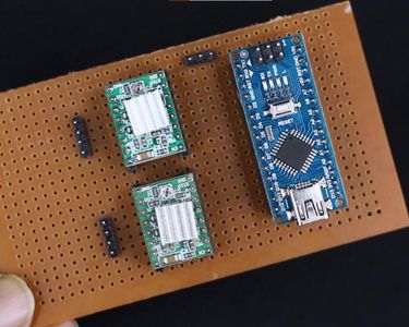

Step 5: Take All Circuit

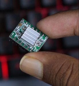

Ready your all circuit.1) 2 PCs A4988 Stepper Motor Driver with heat sink
2)Expansion Board A4988 Driver

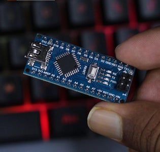

3)Arduino Nano First of all take hit sink and stick on A4988 stepper motor Driver. 2 PCs A4988 Stepper Motor Driver connect on Then this combination connect on Arduino nano (As per circuit Diagram).

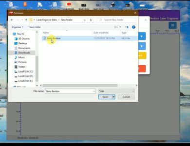

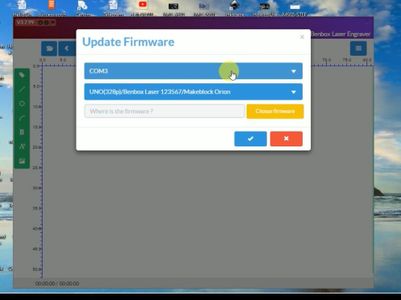

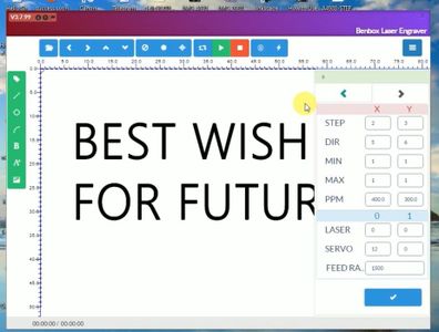

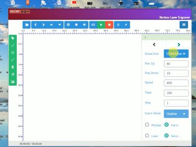

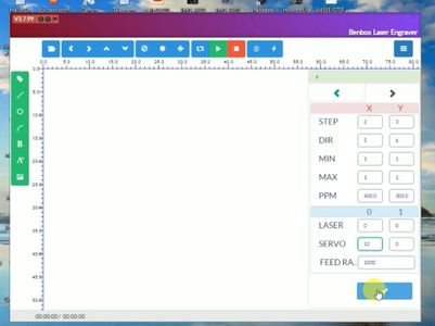

Step 6: Benbox Softwer Configuration.
