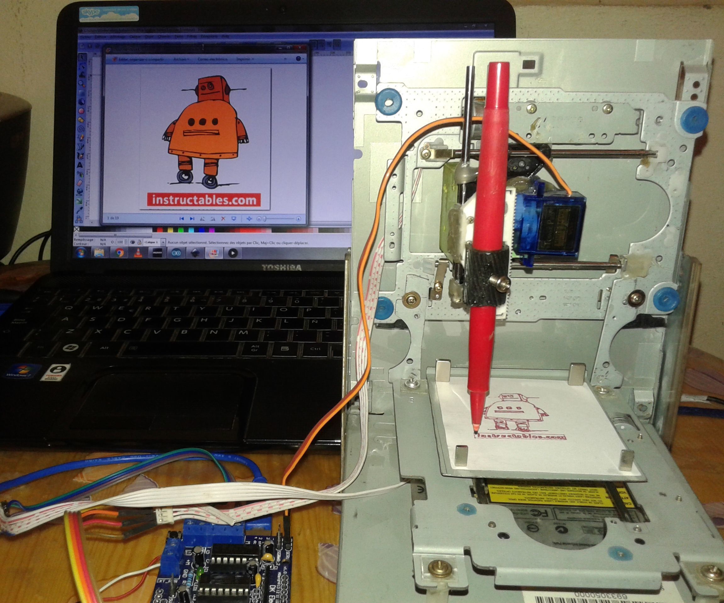

We are building a machine on this shape using old things from plastic or wooden cutting ... taking into account the measurements and angles.
The reader can use the discs as a base tray.
We soldering engine small step in order wire.
We linking the two axes X and Y together constitute Laket 90 degrees like in the picture.
Leave a space between the cover and structure through the use of the same length pieces.
We cut off part of the cover structure dimensions of 7x8 cm to be the basis for drawing them.
Use these magnets installed on the underside of the paper axis "There is a close reading lens"
Thus get to overlie this form. You must note that measurements and angles and should be minimized to the maximum friction as possible, All stepper weak and with less friction difficult for them to move the rotation axes.

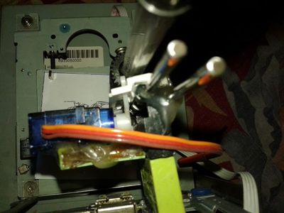

Step 3: Axe Z :
This axis is the most difficult in terms of both composition There is no specific design for him, saluting and we have to use your imagination and you install it according to what you have to cut you may find useful in its design.
But here are some pictures to illustrate the design ( All Pictures)
Saluting the pen hanging on after 6 cm from the horizontal axis Y on a piece of plastic, which in turn linked to a moving axis up and down, taking into account not to move this piece to any direction Swe down or up. The controls in this small servo motor axis (blue)
To prevent the pen from moving in any direction but the bottom or above the rods used as a platform to move the pen.
Lubrication axes to ensure the functioning of the machine series.

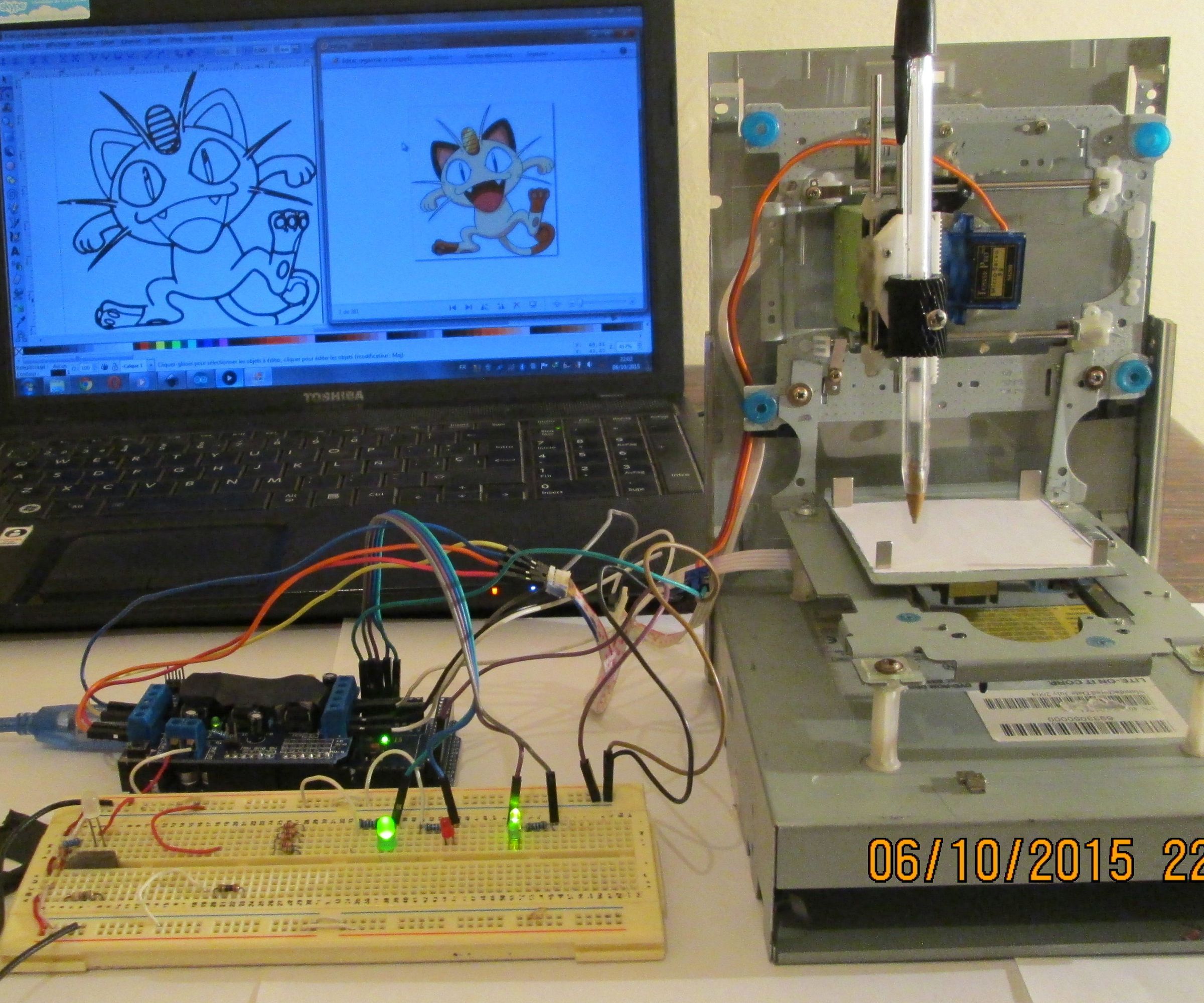

this Gcode file is ready to drawing .
Step 9: This Is Another Video for Mnin CNC With the Increase in Drawing Speed :
Step 10:
Finally Congratulations, you beautiful drawing machine. Greetings from the blog world of electronics.
