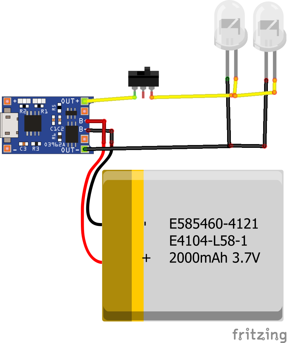

Step 3: Circuit
This is the simple circuit we are using in our lamp, let me explain this for you to understand this better.
The TP4056 charging board is a popular and inexpensive module used for charging lithium-polymer batteries.
It has a micro-USB connector for input power, The charging board has status LEDs to show the charging status.
In the circuit, I have connected the positive (+) terminal of the battery to the B+ terminal of the charging board, and the negative (-) terminal of the battery to the B- terminal of the charging board.
The negative side of the led from two LEDs connected in parallel will be soldered to the output - of the charging board
While the positive side from 2 LEDs connected in parallel will be connected to out + but we will be adding a switch in between these 2 connections

Step 4: Preparing the LED's
Calculate the length of the wire needed by measuring the length of the lamp, and later cut the pieces.
Here we are making the parallel connections between the LED, so we are using the same color wires
Now wind the Copper across the LEDs and solder them to the legs by doing this instead of mere winding you can expect good strength between led and wire connections.
From the last image, you can see that we have made 2 such things that will be used to light the lamp.
