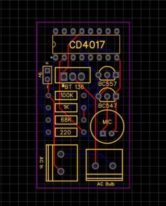

Step 5: Music Activated Circuit Design
The Design of music light circuit along with the PCB layout can be seen above. Power supply included with the circuit.

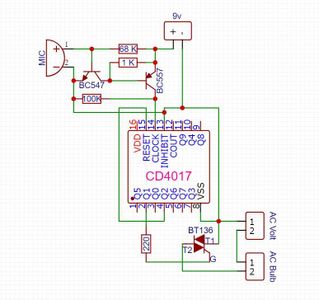

Step 6: Schematic of Music Light Circuit
The schematic of music light circuit along with the PCB layout can be seen above.
Step 7: Connect BC-547 With C-1815 Transistor
To make this music activated light circuit, 1st we need to connect both transistor "Emitter" leg. Then connect C1815 transistor "Collector" leg with "Base" leg of BC547 transistor.
Step 8: Connect Resistor With the Circuit
Now we connect resistor with the circuit. We connect 1 MΩ resistor one terminal with "Source" leg of BT-136 triac and the resistor other terminal with "Base" leg of C1815 transistor. Again connect 10 KΩ resistor with "Gate" leg of BT-136 triac.
Step 9: Connect Capacitor With the Circuit
This time we connect 10µf/ 25v capacitor positive leg with 10 KΩ resistor and the capacitor negative terminal with "Base" leg of C1815 transistor. Next connect 100 KΩ resistor with "Gate" leg of BT-136 triac and it's other terminal with "Collector leg of C1815 transistor.
Then connect BT-136 triac "T1" leg with "Collector" leg of BC547 transistor.
We utilize JLCPCB https://jlcpcb.com/RTA to printout our PCB.
Step 10: Connect MIC With the Circuit
Since it is music activated light circuit, for that we need to connect audio signal receiver with the circuit. For audio signal receiver we are using MIC to make this circuit. We connect MIC positive terminal with 10µf/ 25v capacitor positive leg and MIC negative terminal with "Emitter" leg of BC547 transistor.
Step 11: Connect Holder and AC Cable With the Circuit
To connect AC bulb, we need to connect a bulb holder with the circuit. There are two terminal at a bulb holder. We connect one terminal with "T1" leg of BT-136 triac.
Now we need to connect AC cable with the circuit. We connect AC cable one terminal with "T2" leg of BT-136 triac.
Then connect the rest terminal of bulb holder and AC cable.
Please remember that, we might need to use separator for safety purpose only.
Step 12: Connect DC Power With the Circuit
This time we need to connect a DC power supply with the circuit. For DC power supply, we are using DC-9v.
 We connect DC-9v positive cable with "Gate" leg of BT-136 triac and connect DC-9v negative cable with "Emitter" leg of BC547 transistor.
Step 13: Soldering and Cleaning
Neat and perfect soldering is an important part for all kind of PCBs. Since soldering, you should remember that, there should not be any kind of short circuit connection. After soldering all leg, we cut-off the extra leg of all electronics component.
We also can use liquid PCB cleaner to clean the PCB board.
