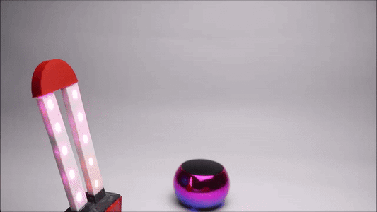

Hello friends Holiday season is around the corner and there will be lots of celebrations why not make it more interesting with this Music reactive Light stand or also you can call it sound reactive light that blinks to the rhythm of music or the sounds.
This is a very useful project because as we all know most of them love listening to the music, If you have some device that follows the rhythm of music it is soo cool to watch! Right?
For those who don't know let me quickly explain to you guys what this device is all about.
Have you seen a soundbar with lights? In modern soundbar system the lights glow according to the beats of music, I have seen in many places and i wanted to make a smaller version of it that can be placed on desktop.
This music reactive light is portable, powered by USB and gives out decent response even for low volume music, I usually place this around my mini speaker and you can see the output which i get from this.
If you have a 3d printer and arduino along with few sensors you can make this under a day and take it to the parties and make this as your desktop gadget.
I have given all the instructions including a working video given in the below steps, happy building and have a great day.

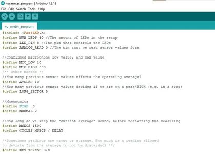

After this is complete, Connect board to computer, Open ide and paste the below code.
One change have to be made in the code, select the number of LED you are using, in my case i was using 10 LED so i changed the numbers

Testing this device is so much fun, Simply connect the Nano board to USB and the other end to power bank or any USB power source.
There is a welcome light! When the device is connected to power source in the starting for a second all the LED light glows and now the device is ready to use.
Play your favourite music on your phone or speaker, Bring it close to this sound sensor and watch the LED strip showing different shades of colors.
Not only for this there are multiple areas where you can use this device for example if you are a player, you can place this near your gaming setup.
You will be amazed to see it working, I have a clip of that in the below step.
