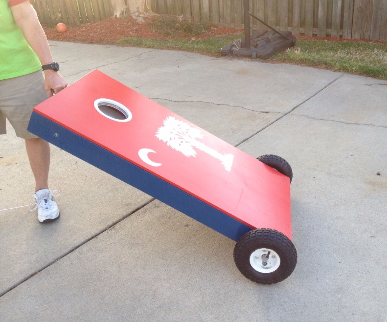

You can expand upon this design and add wheels as well! This process is detailed in my "How to make Rolling Cornhole Boards" Instructable here: https://m.instructables.com/id/How-to-Make-Rolling-Cornhole-Boards/
