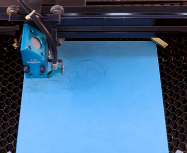

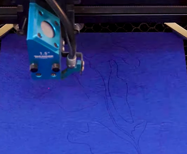

Step 5: Frame the Fabric Ornaments Design and Start Laser Cutting
When you click “Frame”, the red light will display the laser cutting area. This is a safe process, and the frame will align with the non-woven fabric. Once aligned, simply press “Start” to begin the ornaments laser cutting with the Thunder Bolt!
laser world map 3
Step 6: Monitor the Laser Cutting Process
To avoid any issues, carefully monitor the laser cutting, especially when unusual conditions like alarms arise.

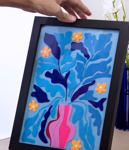

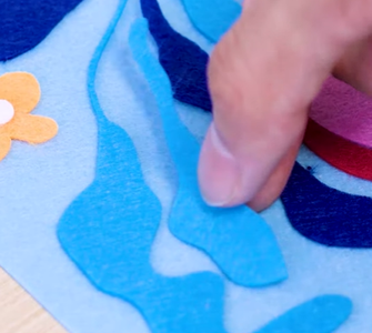

Step 7: Complete the Laser Non-Woven Fabric Ornaments Task
When the laser cutting night non-woven fabric ornaments is completed, it’s time to get it out. Then it’s just a fun assembly time to get the ideal non-woven fabric ornaments. Imagine the joy of assembling the non-woven fabric ornaments, as each piece clicks into place to create a beautiful, layered home decoration.
Laser cutting non-woven fabric ornaments is perfect for home, especially when you’re enjoying a family bonding moment. You can even have your private house laser engraving non-woven fabric ornaments for a one-of-a-kind room style!
