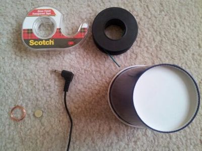

This is a speaker i made from scratch useing scraps i found around my home. The goal of this project was to make a speaker for free out of scrap. The other thing was that i did not use a pre made speaker to make this.
I will show how to make it, so you can build your own :)

soldering iron
solder
scissors
Parts
construction paper
card board
card board tube
audio jack
wire
coated copper magnet wire (This must be atleast 8 ohms to protect your devices)
tape
magnet
PAPER cup
paperclip
Step 2: Make the Speaker
Make a copper wire coil a little bit bigger than the diameter of your magnet.
Place the wire in the center of the bottom of the cup.
Step 3: Make the Speaker 2
Now build a bracket to hold the magnet. The magnet must be placed in the center of the wire coil.
To make the bracket make the paper clip straight. Then tale it io a peice of card board. Then flip it over and tape the magnet on the back side of the bracket.
Make shure you tape secureley because this part must resist the vibrations from the magnetisim when the speaker is on.
