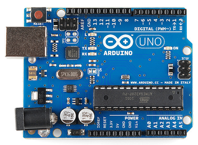

Step 1: All Things You Need for This Project :
All Things You Need For This Project :
1. Arduino Uno - https://amzn.to/3ez28wN
2. Servo Motor - https://amzn.to/3bAJqD5
