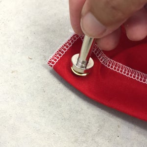

I got all the fabric on sale for about $2/yard, so this project cost me under $18. I chose 42” broadcloth because it is lightweight and cheap. These supplies will make 3 54” buntings. Basically, you make a rectangle, accordion-fold it, secure the center, then sew the ends together down the center. I added grommets at the corners, but you can attach string for hanging instead. The grommet kit was an additional $4 at Joanns and included the anvil and setter tools – all you need is a hammer to set them.

Step 8: Set Grommets
Set grommets in the corners (optional).
