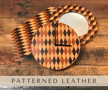

I’ve always been a fan of cutting boards with cool patterns and patterned plywood projects, so I thought I would try to apply some woodworking cutting board/patterned plywood techniques to leather to see if I could make some interesting patterned leather panels that I could then use on some unique products like this simple clock and mirror frame.

Step 4: Creating the Patterned Leather Panel
Once all the strips were cut, I slid each strip one diamond to the left or right which creates the new pattern
As you can see, the tan, cream, chocolate, cream, tan sequence I used creates this double chocolate and then double tan diamond pattern
Now that I had the new pattern laid out, I moved on to gluing the strips to another backing to create a completed panel
For this backing I used leather instead of canvas to give the panel a little more rigidity
I again used some EcoWeld to glue the strips to the leather backing
I started with the longest center strip
Since this first strip would be the reference for all the other strips, I used my ruler to make sure it was perfectly straight
Then I just worked strip by strip until everything was glued together
It can get tricky to remember the correct alignment of each strip as you go, so I took a picture of the pattern before I started to use as a reference as I went and that proved to be very helpful
As I mentioned earlier, the sequence you lay the strips out on the canvas impacts the final pattern
So again, when I did this tan, cream, chocolate, cream, tan sequence I ended up getting this side by side double chocolate and then double tan diamond pattern
Alternatively, let me show you what I got when I did a simple tan, chocolate, cream sequence
As you can see, when I used this sequence, I got this more uniform diamond pattern
