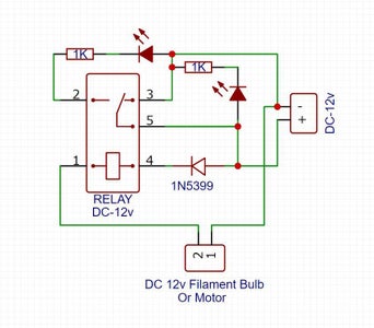

In this project, we are going to teach you making a polarity protection circuit. Polarity protection circuit is an internal circuit that ensures that the device is not damaged if the power supply polarity is reversed.
The circuit cut’s power to the sensitive electronic circuits in the transmitter or transducer. The outlet with reverse polarity can cause some items to be electrically charged at all times.
A direct bias diode placed in the circuit, which will make it only conducts when the polarity is connected correctly. The use of Schottky diodes is recommended, since the voltage drop in these is less.

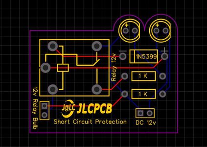

Step 3: Polarity Protection Circuit Design
The schematic of polarity protection circuit along with the PCB layout can be seen above. Power supply don’t included with the circuit. You can use any 12 battery for this project.

Step 6: Connect Relay and Diode With PCB
To make this circuit, we need to assemble relay with the PCB. Then we connect diode negative terminal with 4no leg of relay as the circuit diagram. And we connect diode positive terminal with 5no leg of relay. To make this circuit, we need to assemble relay with the PCB. Then we connect diode negative terminal with 4no leg of relay as the circuit diagram. And we connect diode positive terminal with 5no leg of relay.
Step 7: Connect Resistor With PCBS
We are using 1 KΩ resistor to make this circuit. We connect this resistor one terminal with 3no leg of relay and connect another 1 KΩ resistor with 2no terminal of relay.
Step 8: Connect LED With PCBS
Since, it is a polarity protection circuit. We are using two different color LED light. One is red color and the other is green color LED light. We connect red color led light negative terminal with 1 KΩ resistor, that is connected with 2no terminal of relay. Then the led other terminal will be connected with 3no terminal of relay.
Now we connect our green color LED light. We connect this, green color LED light negative terminal with 1 KΩ resistor, that’s other terminal is connected with 3no terminal of relay and the led positive leg with 5no terminal of relay.
Step 9: Connect Filament Bulb With PCBS
For reverse polarity protection, we are using a DC-12v filament bulb. We connect this bulb with 1no terminal of relay and another terminal with 3no terminal of relay.
Step 10: Soldering and Cleaning
Neat and perfect soldering is an important part for all kind of PCBs. Since soldering, you should remember that, there should not be any kind of short circuit connection. After soldering all leg, we cut-off the extra leg of all electronics component.
We also can use liquid PCB cleaner to clean the PCB board.
