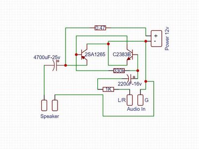

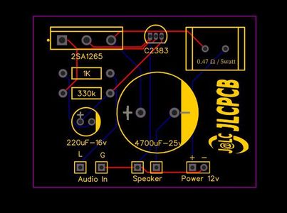

Step 2: Power Amplifier Circuit Design
The schematic of this power amplifier circuit with PCB layout can be seen above. To adjust sound we don’t use any volume. If need, you can adjust sound from your audio input device. You also can use Bluetooth device with this circuit.

Step 4: Connect Transistor
We connect A1265N transistor “Collector” leg with C2383 transistor “Emitter” leg and connect A1265N transistor “Base” leg with C2383 transistor “Collector” leg.
Step 5: Connect Resistor
Now we connect 1KΩ and 330KΩ resistor with the circuit. Connect 330KΩ resistor with “Base” leg of C2383 transistor and it’s other terminal with “Base” leg of A1265N transistor.
Then we connect 1KΩ resistor with 220µf/ 16v capacitor negative leg.
Step 6: Connect Capacitor
Then we connect capacitor with the circuit. To make this circuit, totally we use 2 capacitor. We connect 220µf/ 16v capacitor positive leg with “Base” leg of C2383 transistor and it’s other terminal with 1KΩ resistor.
Now we connect 4700µf/ 25v capacitor with the circuit. Connect it’s positive leg with “Emitter” leg of A1265N transistor.
Step 7: Connect Audio Input Cable
For sound, now we need to connect audio input cable with the circuit. We connect it’s “L/R” cable with empty terminal of 1KΩ resistor and connect audio input “G” cable with “Emitter” leg of C2383 transistor.
Step 8: Connect Speaker Cable
For audio output we need to connect sound speaker with the circuit. We connect speaker one terminal with 4700µf/ 25v capacitor negative leg and connect capacitor other terminal with “Collector” leg of A1265N transistor.
Step 9: Connect Power Supply
This is the last step of this amplifier circuit. For power supply, we are using DC 12v. We connect power supply Positive cable with 0.47Ω resistor and it's other terminal with 4700µf/ 25v capacitor positive leg.
Now connect power supply negative cable with “Emitter” leg of C2383 transistor.
Step 10: Soldering and Cleaning
Neat and perfect soldering is an important part of all kind of PCBs. Since soldering, you should remember that, there should not be any kind of short circuit. After soldering all leg, we cut-off the extra leg of all electronics component.
